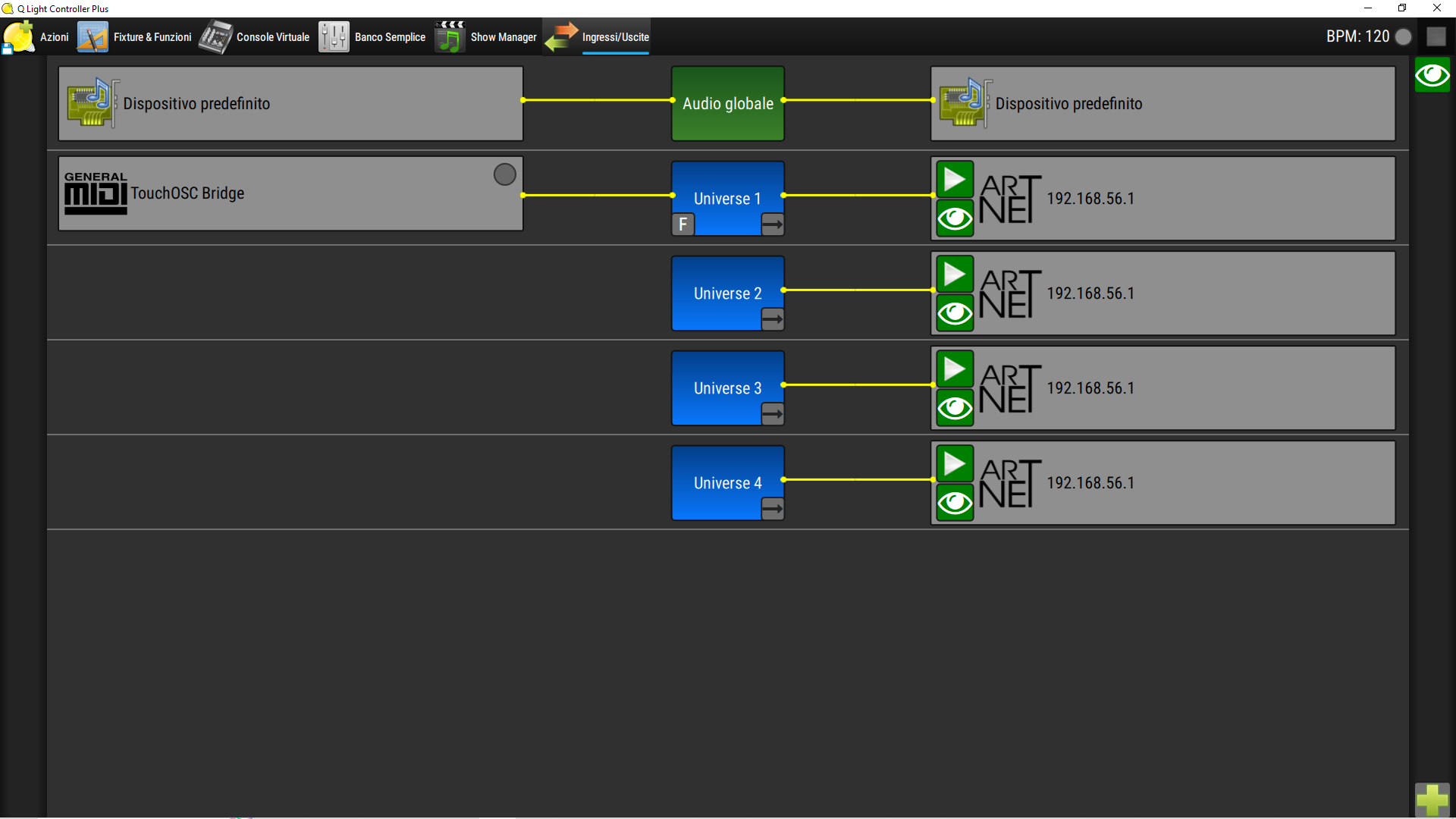

Sorry, I'll go deeper into the "massive design" issue of the layout here because the post didn't let me publish more than 3 images.
I post 2 comparison images below. The first is the input/output screen of QLC+ 4, while the second is that of QLC+ 5. I think the problem is that I used too much space to display too little information. I prefer to have a complete and exhaustive overview of information and to see it equally distributed in the visual space rather than having to open/close side windows than to display hidden information.
Thanks.
